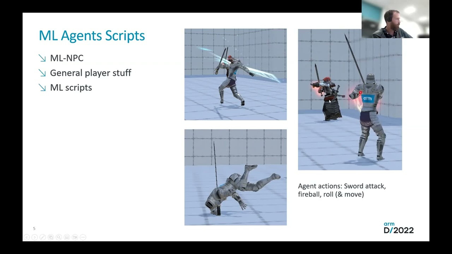

Unity ML-Agents, which can be downloaded from GitHub, allow you to train intelligent game AI agents within games and simulations, with the game characters “learning” through reinforcement learning (RL). There are many different elements when using Unity-ML agents on Arm-based mobile devices, but below are two broad considerations when getting started.
1. Consider how the ML-Agents in the game are designed and what the generated neural network (NN) models look like through the following items:
Input to the agent and what information it needs.
Outputs from the agent and which actions it needs to take to accomplish a target task in the game.
The NN model structure and how the brain should process information.
The reward function and how the agent will be trained.

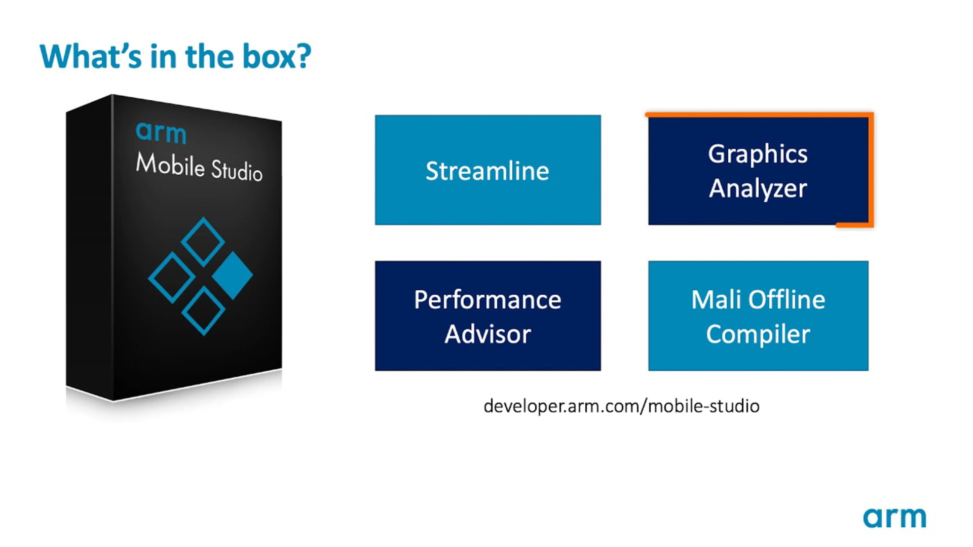

Away from the Unity tools and methods, you can also optimize the performance and efficiency of your games through Arm Performance Studio, which can be downloaded for free here.
This is a suite of optimization tools for mobile games that provide you with early and frequent testing around gaming and graphics performance. This quickly identifies areas that can be optimized to reduce profiling time, helping you predict and improve game performance and efficiency. Each tool targets a different stage in the profiling workflow for gaming applications:
Performance advisor: This generates an easy-to-read performance report from an annotated Streamline capture and gives actionable suggestions about how to optimize the gaming application.
Streamline: This captures a performance profile for deep-dive analysis, using all of the CPU, GPU, and memory system performance data. All of these metrics allow game developers to target optimizations to the areas that matter most.
Graphics Analyzer: This investigates the OpenGL ES and Vulkan API calls made by the application and how the GPU reacted to them to identify rendering defects and performance inefficiencies. The tool uses diagnostic tooling, such as overdraw and shader usage maps, to explore the frames of the application draw-by-draw and find opportunities for optimization.
Mali Offline Compiler: This compiles the application’s shader programs and checks how they will perform across any Arm GPU. Performance reports from this tool give game developers information on shader register usage and thread occupancy, an estimated cycle cost breakdown for the target GPU, and other stage-specific performance feedback.
